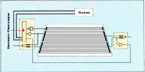

    All newer BMWs have the in-glass electronic systems by Fuba. The following information applies to these cars as follows: E31 - E32 - E34 - E36 and up
    These cars have 2 or 3 antennas in the rear glass, including one which is the defroster wires, all embedded or printed on the inside of the glass. The usual configuration is a small computer/antenna selector/signal amplifier in the left side C-pillar. This small box can be accessed by removing rear seats completely then removing large plastic trim panel.
    The "box" gets a signal from the radio via a thin (aprox 1/8") coaxial cable. This is an IF (Intermediate Frequency) signal out of the radio. My best guess is that it comes as a variable voltage level not a data signal. The computer uses this information from the radio to learn how strong the reception is at a given instant. As usual for a computer, antenna or antennas are selected at maybe 30 or 60 times per second. It is possible for the computer to select 1 single antenna or combine 2 and maybe 3.
    If the original BMW radio is replaced with an aftermarket radio, the computer defaults to one antenna, probably the largest array. The reception quality will become fairly poor using a single antenna in the rear glass. The best solution apart from re-installing the original radio is to install a single antenna in the rear fender, the old fashioned, old reliable way. Otherwise an aftermarket radio with 2 antenna inputs (diversity system) would be a near remedy: In this case use the default antenna in the rear glass plus an aftermarket small electronic antenna inside the front glass.

      "Aftermarket" mankoissa täytyy sininen tai vihreä johto ( power antenna) soittimelta kytkeä E34/E36:n liittimen pinniin nro.16 (BMW liittimen valkoinen johto), että anteenivahvistin saa virtaa.
      Edit: Lainataas vähän E34netistä:
      Note: No reception on the AM band means the power is somehow disconnected from the antenna box in the C-pillar. Check for voltage at the box itself. Many times when installing an aftermarket radio the power lead to the antenna box is left disconnected. It should go to the power-antenna lead, (blue or green) of the aftermarket radio.
