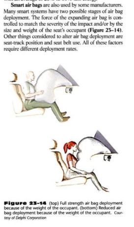

      Let's take a look at one popular OCS made by Delphi. Inside the seat, you will find a pressure sensor, a silicone-filled "bladder", and an electronic control unit (ECU). When someone sits on the seat, the pressure sensor signals the occupant's weight to the ECU. The ECU then sends that data to the airbag, which has its own control unit. Based on that information, the vehicle's computer turns the passenger airbag on or off.
      The OCS doesn't just detect weight. It reads the passenger's seating position and determines if they're wearing a seat belt. It also has a seat belt tension sensor that allows the OCS to interpret the pressure created when a child seat is fitted. In other words, the system is designed to tell whether a child safety seat is occupying that seat or whether you're just carrying some heavy object there. A light or sign on the instrument panel tells the driver whether the passenger airbag is on or off.
      Once the onboard computer knows the passenger's size and weight, the car's dual stage airbags come into play. Based on the occupants' size, these types of airbags can deploy at full speed, partial speed, or not at all. An airbag deploying at full speed can badly injure or even kill a child or small adult. In addition, dual stage airbags also can deploy at lesser speeds when the car is involved in a minor collision.

        Seuraavaksi voikin sitten iltalukemistona lukea BMW:n oman kuvaukse E6x-sarjan turvallisuusjärjestelmästä. Jo niissä on ollut melko merkittävä määrä erilaisia lisäantureita ja niissäkin jo tunnistinmatto määrittää, onko matkustajan paikalla lastenistuin, pieni henkilö vai täysikokoinen aikuinen.
        Lisäksi on mallikohtaisia hienouksia, kuten esim E64-sarjassa penkin kaltevuuden tunnistus (jos penkki on kallistettuna, niin bägiä ei laukaista). Laitapa tuollaiseen sitten huijauslaite...
        Ja uudemmissa korimalleissa on vielä paljon kehitetty lisää, joten se istuinmatto ei todellakaan ole mikään ylimääräinen haitta jonka nyt tästä äkkiä fiksaan parilla apikolla.
