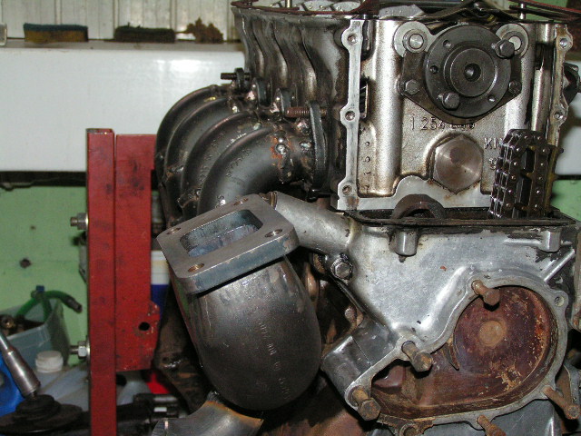

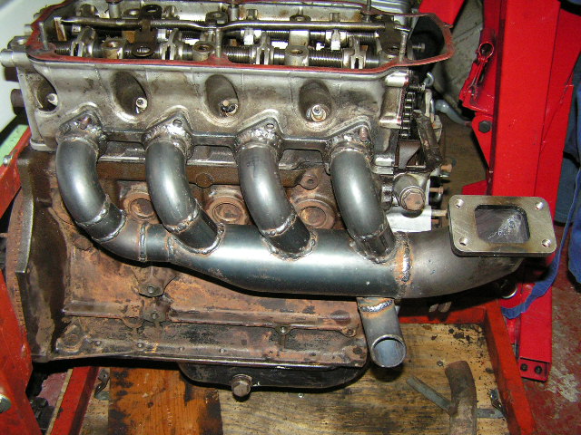

          Here is a pic of the exhaustmanifold we made with a friend of mine.
          The car has now around 125pk only by smooth tuning and better breathing with the bigger throttlebody. So this will be a good base for the turbo.
