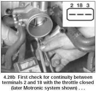

                        Kaasuläpänasentotunnistimen (TPS) tarkistus ja säätöohjeet by Haynes:
                        Check
                        28 Remove the electrical connector from the TPS, and connect an ohmmeter to terminals 2 and 18 (see illustrations). Open the throttle slightly by hand. Release the throttle slowly until it reaches 0.2 to 0.6 mm from the throttle stop. There should be continuity.
                        29 Check the resistance between terminals 3 and 18 as the throttle is opened. There should be continuity when the throttle switch is within 8 to 12 degrees of fully-open. If the readings are incorrect, adjust the TPS.
                        30 If all the resistance readings are correct and the TPS is properly adjusted, check for power (5 volts) at the sensor, and if necessary trace any wiring circuit problems between the sensor and ECU (see Chapter 12).
                        Adjustment
                        31 If the adjustment is not as specified (paragraphs 28 to 30), loosen the screws on the TPS, and rotate the sensor into the correct adjustment. Follow the procedure for checking the TPS given above, and tighten the screws when the setting is correct.
                        32 Recheck the TPS once more; if the readings are correct, reconnect the TPS harness connector.
