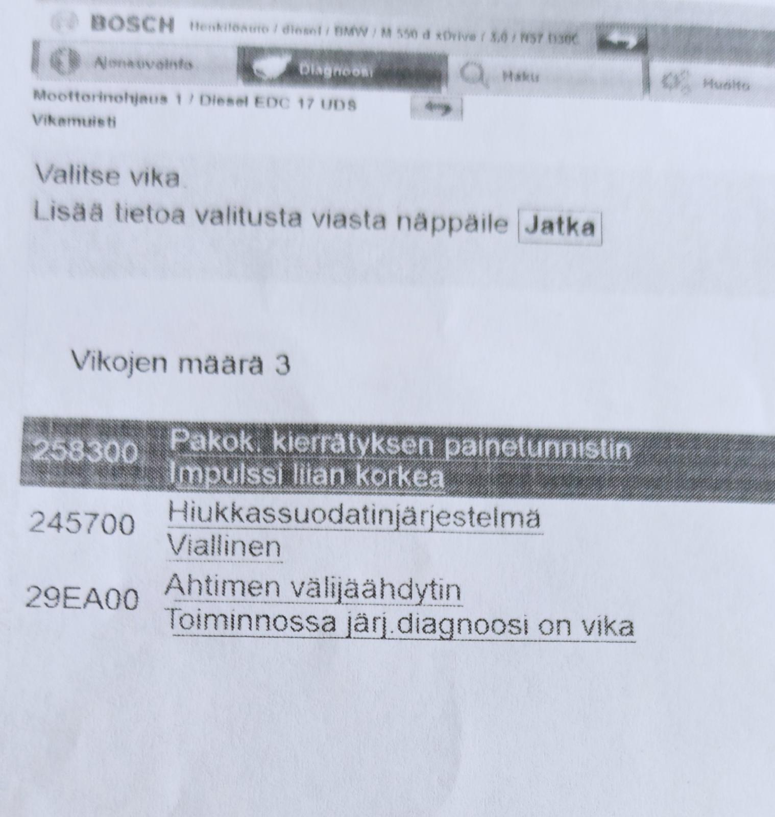

      Lainataan tätä lankaa, kun omassa vastaavia oireita.
      Reissusta palatessa heitti drivetrain herjan eikä vetänyt ylhäältä ollenkaan. Hipsuttelin varovasti loppumatkan kotiin ja ylämäissä, kun vetoja olisi tarvittu enemmän alkoi savuttamaan aika reilusti.
      Vikakoodeja, jotka oli tallentuneet:
      29EA00 Charge air cooler, plausibility, Cooler efficiency too low
      244C00 Charging pressure control, control deviation: Charging pressure too low/positive
      25DB00 Exhaust back pressure sensor upstream of diesel particulate filter
      245800 Particulate filter system: Particulate filter heavily clogged (exhaust-gas back-press..)
      245700 Particulate filter system: Particulate filter heavily clogged (exhaust backpressure hi)
      240400 Exhaust gas recirculation, control deviation: Air mass too low/positive control devia)
      25C400 Exhaust back pressure sensor upstream of diesel particulate filter
      245400 Particulate system: minimum differential pressure undershot
      244D00 Charging pressure control, control deviation: Charging pressure too high/negative
      24CF00 Air mass measurement: Measured air is too low compared with the calculated..
      2AB400 Charging pressure sensor, plausibility: Value implausible for pressure upstream of ..
      290B00 Air system, air to EGR air mass flow, plausibility: Measured air mass compared with calculated..
      28ED00 Pressure sensor, plausibility in after-run: Exhaust pressure before turbocharger no..
      25D000 Charging pressure sensor, Signal: Short circuit to B+
      258300 Exhaust gas pressure sensor, diesel particulate filter, signal: Signal too high
      Nollasin vikakoodit ja ajelin jonkin verran, ja näistä vikakoodeista toistui:
      2AB400 Charging pressure sensor, plausibility: Value implausible for pressure upstream of..
      245400 Particulate filter system: minimum differential pressure undershot
      24CF00 Air mass measurement: Measured air mass is too low compared with the calculate..
      25D000 Charging pressure sensor, signa: Short circuit to B+
      290B00 Air system, air to EGR air mass flow, plausibility: Measured air mass compared wit..
      244D00 Charging pressure control, control deviation: Charging pressure too high/negative..
      Yritin katsoa vastapaineet, mutta ista antoi miinusmerkkisiä arvoja. Tyhjäkäynnillä Actual value: -5.0 mbar ja 2000 rpm Actual value: -6.0 mbar. Soot mass 1.34g.
      Onko ehdotuksia miten tässä pitkässä listassa kannattaisi edetä? Vaihtaako suosiolla vaan noita antureita ja katsoo mitä vaikutusta? Mitä muita potentiaalisia tarkastelun paikkoja raadilla näistä tulee mieleen? En ole vielä ehtinyt varsinaisesti sen enempää asiaa tutkimaan, kuin lukasin vikakoodit ja tsekkasin nuo vastapaineet.
      Kuten tuossa sanottiin jo edellä, niin se vastapaineanturi on rikki. Ei voi olla negatiivinen vastapaine -> kun anturi kuitenkin näyttää lukemia, niin anturi on rikki. Näitä menee jonkun verran. Uusi anturi ja katsomaan mikä se todellinen vastapaine on ettei ole dpf tukossa. Toiseksi tarkistaisin ettei ahtoputkissa ole vuotoa.

        Kiitos näistä kommenteista. Lähden näillä liikkeelle ja katsotaan miltä sitten näyttää.

          Vielä varmistuksena. Mikä se vastapaineanturi todellisuudessa on? Dpf:n yhteydessä on 2kpl exhaust pressure sensoreita. Onkohan jompi kumpi noista vai vaaditaanko vastapaineen mittaukseen molemmat?
            Tuollaiset herjat löyty omasta kulkineesta.
            Onko tuo ensimmäinen egr vikaan liittyvä vai dpf herja sekin?
            Tarkoitus olisi auto ohjelmoida. Siinä tuo toinen vika ilmeisesti hoituu mutta mikäs tuo kolmas vika on?
            Auto siis F10 m550d.
              Veikataan, että EGR liittyy, tosin ei noista Boschin suomenkielisistä koodeista ota erkkikään selvää. Lukaise ISTA:lla ne koodit, jos ei itseltä/kaverilta löydy, niin joku foorumilainen voi auttaa.

                Numeron mukaan exhaust back pressure sensor, eli ei liity egr. Siksi myös toinen vikakoodi. Kuten todettua, kannattaa lukea istalla niin saa tarkan kuvauksen höpöhöpö koodin sijaan.
                  Juu eli nuo 2 ekaa koodia on dpf herjoja..??
                  Onko tuo kolmas sit ihan eri vika vai voisko sekin liittyä samaan..??
                  Kyllä se on "oikeat" koodinluku laitteet hommattava ku tulee sopivasti vastaan.
                  Täytyy käydä alkuun ny jossain mistä löytyy ista..

                    Juu DPF poltto ei toimi tällä hetkellä tuosta anturi viasta johtuen, eli kannattaa pikimmiten laittaa kuntoon että ei tukkeudu pönttö.

                      Vikakoodeja voi koittaa laittaa tuonne ja katsoa mitä se kertoo.
                      Ja kuten muutkin jo sanoivat niin Ista on oikea ohjelma bemarin koodien lukemiseen.
                        Pitää tilata tuo anturi nyt alkuunsa ja kattoo jos ne poltot sais taas toimimaan..?
                        Onko se nyt tämä osa?
                        Differential Pressure Sensor 13-62-7-805-758
                          Varmistaisin nyt ensin ISTA:lla, siellä kun on tuon lisäksi vielä muistaakseni paineanturi. Kun ongelma on korjattu, niin koodit pitää nollata ja luultavasti vaatii pakkopolttoa, että lähtee polttamaan, kun koodien mukaan on jo liian paljon vastapainetta.
                            Nyt vihdoinkin ehdin tätä asiaa hieman edistämään. Nyt sain vastapaineita mitattua. Tyhjäkäynnillä näyttää edelleen negatiivisia arvoja, mutta 2000 rpm 57 mbar ja 4000 rpm 148 mbar. Mistähän tuo tyhjäkäynnin mittausongelma voi johtua? Ilmeisesti vastapaineet on kuitenkin ok 2000 rpm ja 4000 rpm? Täytynee alkaa tutkitaan mahdollisia ahtovuotoja.
                              Vaikkapa viallisesta anturista. Onko se jo vaihdettu ja tilanne edelleen sama?
                                En vaihtanut anturia, koska anturille menevä letku oli irti. Nyt kun letku on takaisin kiinni, sain vastapaineet kierroksilla mitattua. On mulla tossa uusi anturikin, mutta en vielä vaihtanut kun alkoi saamaan järkeviä lukemia vanhallakin anturilla.
