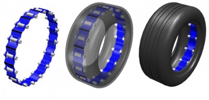

    Toyo has developed a new device that effectively reduces resonance in tire cavities, which is one of the main sources of interior noise. Engineers conducted simulations to visualize the air
