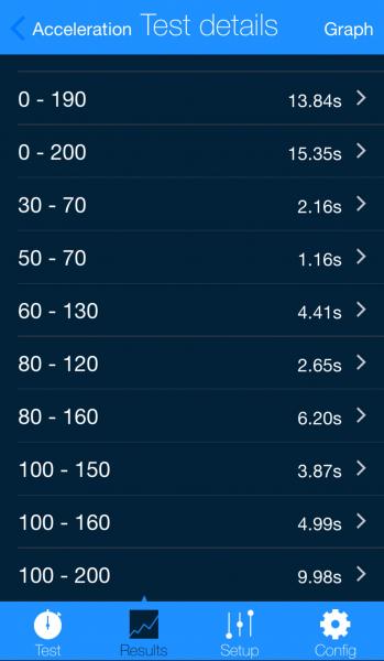

          #979
          BMW E60 535dA ///M-Sport 2009
          454hp/850Nm
          100-200kmh@9,98s
          0-200kmh@15,35s
          1/4 mile 12,82s@185,8kmh
          1 mile 259kmh
