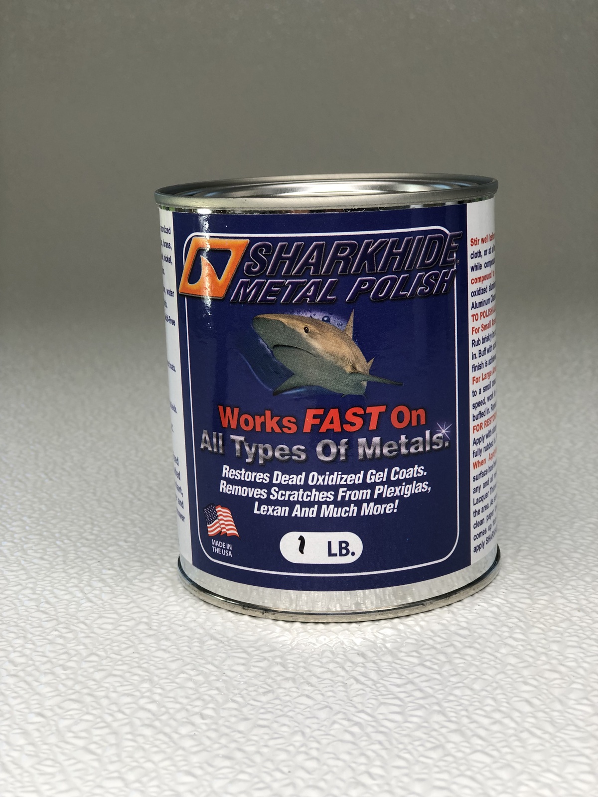

    Sharkide Metal Protectant
    Tälläisiä tuli vastaan. Onko kokemuksia?
    A single-step polish that works not only on aluminum, but copper, brass, steel, S/S, magnesium, chrome, and even removes scratches from plexiglass.
    We provide a thin, invisible coating that protects against oxidation, corrosion, streaking, staining, and discoloring. Easy to apply and dries in seconds!
    These wheels were last polished
    and coated with Sharkide Metal Protectant back in 1993!
    http://www.eastwood.com/sharkhide-al...ant-quart.html
