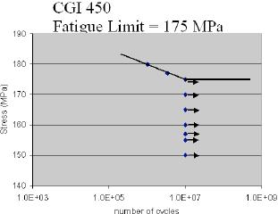

      Note that fatigue strength S falls steadily and linearly as a function of N until reaching a knee at about 10^6 to 10^7 cycles. This knee defines an endurance limit for the material, which is a stress level below which it can be cycled infinitely without failure.
      Not all materials exhibit this knee.
      Materials, such as "aluminium, magnesium, copper, nickel alloys, some stainless steels, and high-strength carbon and alloy steels" show S-N curves that continue to fall with increasing N, though the slope may become smaller beyond about 10^7 cycles.

                        Patarauta nyt on mitä on. Alumiinin iso ongelma on lujuuden menetys korkeammissa lämpötiloissa. Tänä päivänä on onneksi muitakin vaihtoehtoja kuin patarauta:
                        The thermal and damping characteristics of CGI are midway between ductile and gray iron. It is five times more fatigue resistant than aluminum at elevated temperatures, and twice as resistant to metal fatigue as gray iron.
                        Otetaanpa Hemille muuta lainaus samasta lähteestä:
                        Hyundai, currently the number seven automobile company in the world, and rising, has V6 CGI blocks scheduled for full series production during 2006. Its World Rally Championship car (1997-99) also had a CGI engine block.
                        General Motors’ Opel subsidiary has used CGI for the engine block of its 2.5-liter V6 DTM racing engine. Theoretically, a CGI engine block can be fabricated lighter than an aluminum block for equal power densities.
                        A recent 500cc Suzuki Grand Prix motorcycle engine had a crankcase fabricated from CGI. Nothing is put on these racing machines that would pose any kind of a weight penalty, and this is an extreme example showing the real potential of CGI applications.
                        Ja syy tuon tylppägrafiitti-valuraudan käyttämiseen ei todellakaan ole halpa hinta. Sen valmistusprosessi on varsin hankala hallita ja koneistaminekaan ei ole mitenkään edullista. Mikä erikoisinta, niin tämän täysin ala-arvoisen valuraudan käyttö on koko ajan yleistymässä. Pian se saattaa ottaa osuudensa muistakin osista kuin dieseleiden lohkoista.
