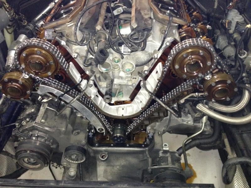

                  Here we go...
                  (Suluissa on mahdollisesti mainittu vastaava laadukas tarvikeosa Elring/Lemförder)
                  S62 Timing Chain Guide Replacement Including Full VANOS Refurb
                  11141275466 x 1 (Shaft seal - Lower Timing Case)
                  11140001186 x 2 (Upper Timing Cover Gasket Sets)
                  11140001187 x 1 (Gasket Seal - Lower Timing case)
                  11431707164 x 2 (O-ring)
                  11131407532 x 1 (Steel Gasket - Oil Pan Bottom)
                  07119963151 x 1 (Gasket Ring - Oil Pan Bottom)
                  11311407052 x 1 (Timing Chain - Timing - Timing Chain Lower P)
                  11311406366 x 1 (Deflection Rail - Timing - Timing Chain Lower P)
                  11311406280 x 1 (Guide Rail - Timing - Timing Chain Lower P)
                  11311407337 x 1 (Chain Tensioner Rail - Timing - Timing Chain Lower P)
                  11311406261 x 1 (Hydraulic Chain Tensioner - Timing - Timing Chain Lower P)
                  07119963355 x 1 (Gasket Ring - Timing - Timing Chain Lower P)
                  11311406167 x 3 (Chain - Timing Gear / 2 x Timing Chains Top + 1 x Oil Pump Chain)
                  11311406165 x 1 (Chain Tensioner - Timing Gear / Timimg Chain Top - Cyl 1-4)
                  11311406166 x 1 (Chain Tensioner - Timing Gear / Timimg Chain Top - Cyl 5-8)
                  11411407056 x 1 (Chain Tensioner - Oil Pump)
                  07119905695 x 1 (Circlip for Oil Pump Chain tensioner)
                  11367830147 x 1 (Hose Elbow)
                  11151407344 x 1 (Return Hose - Crankcase-Ventilation/oil separator)
                  11151406902 x 1 (Return Hose - Crankcase-Ventilation/oil separator)
                  07129952107 x 2 (Hose Clamp - Crankcase-Ventilation/oil separator)
                  11151406900 x 1 (Return Hose - Crankcase-Ventilation/oil separator)
                  11120001269 x 1 (Profile Gasket Cyl 1-4 - Cylinder Head Cover) (Elring 711.990)
                  11120001278 x 1 (Profile Gasket Cyl 5-8 - Cylinder Head Cover) (Elring 712.000)
                  11121721879 x 6 (Rubber Seal - Cylinder Head Cover) (Elring 767.891)
                  11121437395 x 20 (Rubber Seal - Cylinder Head Cover) (Elring 436.010)
                  11511407806 x 1 (Water Pump - Replace if still original)
                  11511406765 x 1 (Steel Gasket - Water Pump)
                  11231402618 x 4 (Torx Bolt - Belt Drive-Vibration Damper)
                  11537835558 x 1 (Thermostat - Replace if older than one year)
                  11531710055 x 1 (O-ring for Water Pump)
                  11531407002 x 4 (O-ring - Lubrication System Engine Oil Cooling)
                  11531406249 x 6 (O-ring - Cooling System)
                  11367830828 x 8 (Solenoid O-Rings)
                  11367830829 x 8 (Solenoid O-Rings)
                  11361406838 x 2 (Cover gasket)
                  11367833218 x 4 (Diaphragm Spring Sets)
                  11361406944 x 2 (Washer)
                  07119934749 x 2 (Lock Ring)
                  11311317318 x 4 (O-ring)
                  11361406377 x 2 (O-ring)
                  11311317732 x 2 (O-ring)
                  11361406868 x 2 (O-ring)
                  11411306082 x 2 (O-ring - VANOS)
                  07119963072 x 4 (Copper Gasket Ring - VANOS)
                  07119919625 x 24 (Filister Head Screws - Timing Gear / Timimg Chain Top)
                  07119913589 x 24 (10.9-Rated Hex Bolts - Timing Gear Timing Chain Top)
                  11361401971 x 1 (Filter - 100bar oil regulator valve)
                  11311318659 x 1 (O-ring - 100bar oil regulator valve)
                  11361403325 x 1 (O-ring - 100bar oil regulator valve)
                  Spark Plugs x 8 (NGK BKR6EQUP Laser Platinum - Optional)
                  11311741808 x 2 (Torx Bolt for Central V-Rail - Optional)
                  11311731952 x 2 (Torx Bolt for Cenral V-Rail - Optional)
                  11311731951 x 1 (Torx Bolt for Central V-Rail - Optional)

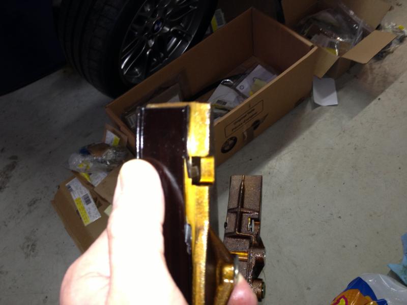

                  Ohessa vielä KK-laakerien vaihtotyön kattava lista:
                  Rod Bearing Replacement
                  11131407532 x 1 (Steel Gasket - Oil Pan Bottom) (Elring 496.250)
                  11137831014 x 1 (Steel Gasket Upper Oil Pan) (Elring 496.242)
                  11137830114 x 2 (O-ring)
                  11137830113 x 2 (O-ring)
                  11137830112 x 2 (O-ring)
                  11441406693 x 2 (O-ring)
                  11421741129 x 1 (O-ring)
                  11421406872 x 1 (O-ring)
                  11131406864 x 1 (Oil Pipe)
                  11421713597 x 1 (O-ring)
                  11421407015 x 1 (O-ring)
                  11411304178 x 1 (O-ring)
                  07119963151 x 1 (Gasket Ring Oil Pan Bottom)
                  11241407493 x 8 (Rod Bearing Shell 49,00mm BLUE)
                  11241407492 x 8 (Rod Bearing Shell 49,00mm RED)
                  11241405890 x 16 (Rod Bolt M10 x 1.25 - 5Nm -> 20Nm -> 65deg angle - E12 female/reverse torx socket)
                  07119932842 x 1 (Circlip)
                  07119963201 x 4 (Gasket Ring)
                  07119963129 x 5 (Gasket ring)
                  31121092167 x 2 (Hex bolt)
                  31121093462 x 2 (Hex bolt)
                  31121092165 x 2 (Hex bolt)
                  33306760349 x 2 (Nut)
                  33326760668 x 2 (Nut)
                  33306760587 x 2 (Nut)
                  32201092453 x 2 (Nut - Might be 07119905032)
                  32201142083 x 1 (Inner Hex Bolt)
                  07129964672 x 1 (Self-locking Hex Nut)
                  32201092452 x 1 (Collar Screw)
                  32201092453 x 1 (Self-locking Hex Nut)
                  07119963200 x 2 (Gasket Ring)
                  Cheap optional additions:
                  07119913115 x 20 (Hex Bolt)
                  11421702917 x 4 (O-ring - Scavending pipes in the upper oil pan)
                  07119901601 x 4 (Hex Bolt Oil Pump Cover - Loctite)
                  11417549652 x 1 (Hex Nut - 47Nm nut in the oil pumps sprocket)
                  07119901600 x 3 (Hex Nut - Nuts in the plate behind oil pump sprocket - loctite)
                  (Joillakin henkilöillä M5Boardilla vanhat 07119901601 & 07119901600 ovat katkenneet TIS:n momenttispekseillä)
