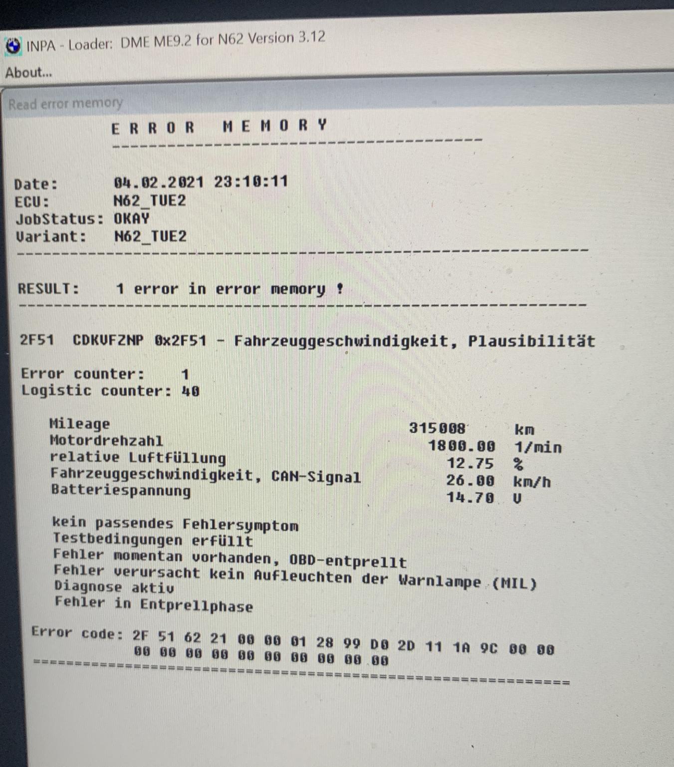

                Mistä mahtaa tämä dme ssä useasti oleva koodi johtua?
                E70 X5 4.8i
                ex: E46 325Ci

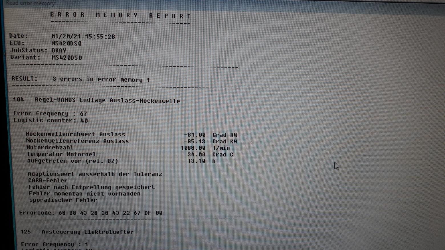

                  Auto aloitti epätasaisen tyhjäkäynnin, tapahtuu usein kylmänä ja kuumana, mutta ei kuitenkaan aina. Aivan aamun ensimmäisessä käynnistykessä käynti on normaalia. Alkanut myös viime aikoina sauhuttaa kylmänä aika paljon, sellaista valkoista sauhua.
                  Luin vikakoodit DeepOBD:lla:
                  DME/DDE (Digital Diesel Electronics):
                  Error code: 4C2E
                  DDE control unit internal, Fault currently not present
                  Environmental conditions:
                  - Frequency: 16
                  - Logistics counter: 40
                  - Mileage/km reading: 256008 km | 257576 km
                  - Engine speed: 3010.5 1/min | 1967.5 1/min
                  - Coolant temperature (sensor value before correction): 87.09 degC | 63.08 degC
                  - maximum rail pressure of last 10 ms (1 byte): 1673.76 bar | 1312.29 bar
                  - Fuel injection quantity - setpoint value without quantity-compensation control (1 byte): 75.74 mg/Hub | 72.6 mg/Hub
                  Error code: 4C29
                  - Frequency: 16
                  Error code: 4C2F
                  - Frequency: 15
                  - Engine speed: 3017.5 1/min | 1964.5 1/min
                  - maximum rail pressure of last 10 ms (1 byte): 1673.76 bar | 1328.01 bar
                  - Fuel injection quantity - setpoint value without quantity-compensation control (1 byte): 76.13 mg/Hub | 72.6 mg/Hub
                  Error code (Shadow): 41FD
                  DDE: DDE control module internal, Fault currently present, Program-version check not OK, Fault does not trigger a driver information at the moment.
                  Error code (Shadow): 41ED
                  DDE: DDE control module internal, Fault currently present, Data-record check not OK, Fault does not trigger a driver information at the moment.
                  Error code (Shadow): 4CA4
                  4CA4 Abgasrückführventil, Plausibilität, Fehler momentan nicht vorhanden, aber bereits gespeichert
                  KOMBI (Instrument cluster):
                  Error code: A559
                  Dashboard: Dashboard: voltage supply switched off, Fault currently not present
                  - Frequency: -1
                  - Mileage/km reading: 256888 km
                  - Power supply: 12.1 V
                  LM (Lights Module):
                  Error code: 9CC5
                  LM: No LIN message (RLS), Fault not currently present
                  - Frequency: 59
                  - Mileage/km reading: 257472 km
                  - Battery voltage: 12.49 V
                  - Sensor voltage: 0 V
                  Mistähän alkaisi painimaan ensimmäisenä?

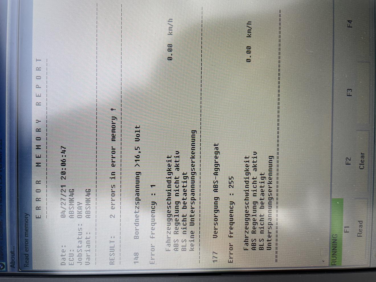

                        -95 320i M52 E36:ssa ABS valot lävähti tauluun ja tämmöstä koodia Inpa antaa. Mitähän tämä nyt voisi olla suomeksi sanottuna?
                        Edit: ilmeisesti abs pumpulta tuo toinen? Mitäs tuo toinen koodi mahdollisesti tarkottaa, jossa jännite 16,5v?
                          Ensimmäinen meinaa, että jännite olisi ollut yli 16,5V. Voisi olla jännitteensäädin. Ei mikään ihme, että ABS valot tuolloin lävähtää tauluun.

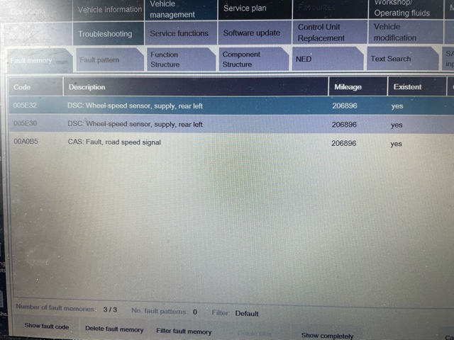

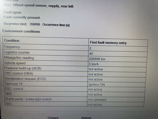

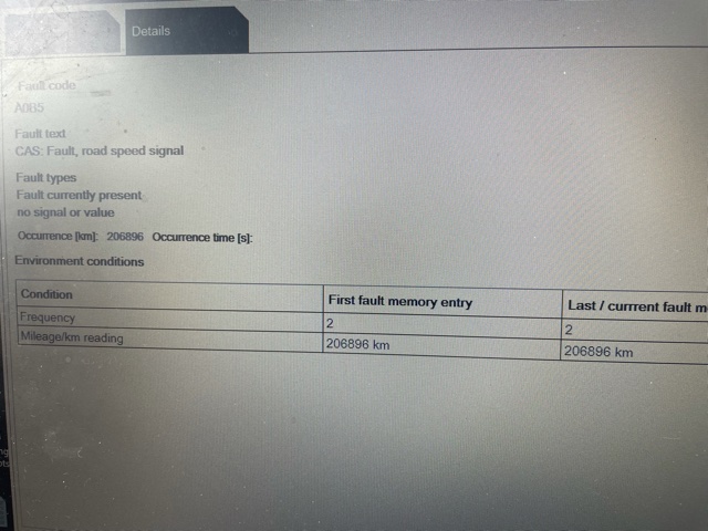

                            DSC: road speed signal, no signal or value
                            Vanhemmassa 530d E60 autossa tuli oheisissa kuvissa näkyvä vikakoodi. Vaihdoin vasemman takapyörän nopeus/ABS-anturin uuteen nähdäkseni oliko tässä vika. Se ei auttanut. Anturille tuleva johto on kunnossa ulkoa päin sillä matkalla mitä se on näkyvissä ilman lokasuojamuovien tai pohjalevyn poistamista.
                            Onko johdon katkeaminen yleistä? Miten voisin varmistaa onko vika siinä?
                            Mikä muu voisi olla ongelmana?
                              • 10954
                              #704
                              Varmin tapa on käyttää oskilloskooppia.
